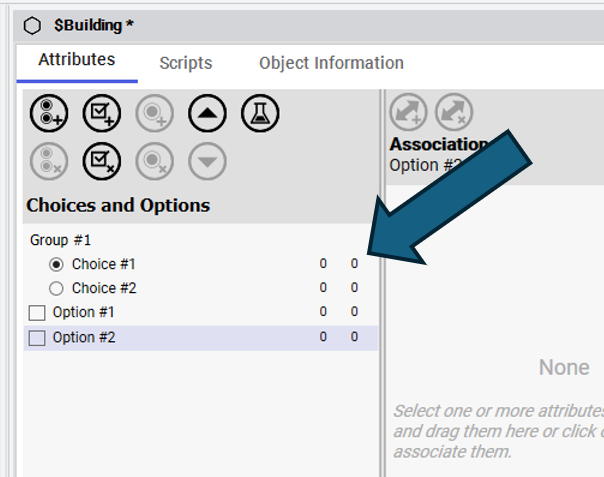

Access to Object Wizard attributes
Make attributes on Choices and Option in the Object Wizard reachable from script.
Complex script might be dependent on the choices made. Better to read the choice than to have several versions of the script assigned to each individual choice.
