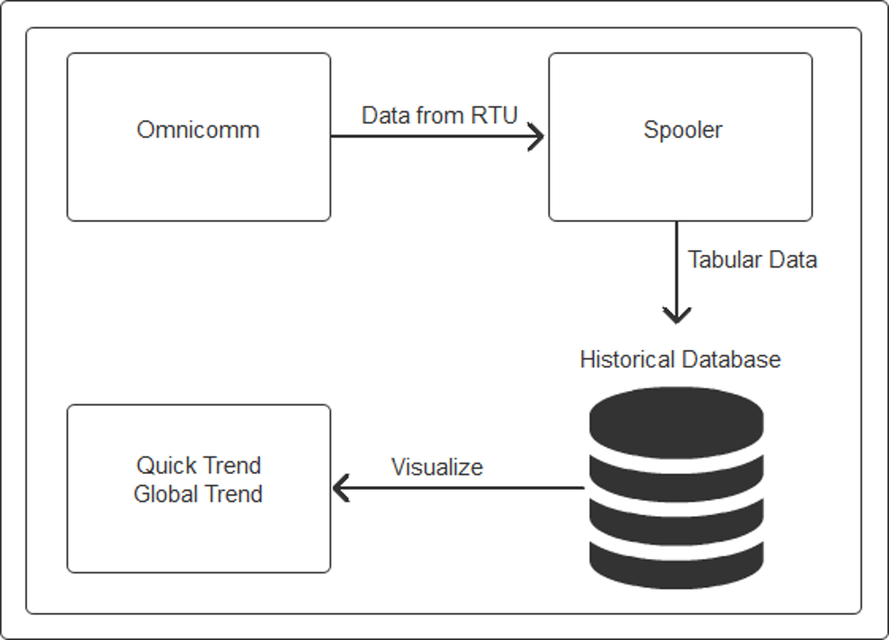

    Field Device Trend History
    When Historical point data is stored in a Remote Terminal Unit (RTU) data logger, this application enables you to configure the system such that it sends the data to the Historical database.
    When analog collect records are configured with the collect type "device based history", Omnicomm sends the Historical data collected from the RTU to a spooler, which in turn calls a stored procedure in the Historical database that adds data to the TimeSeries database. This provides Controllers with immediate access to the data for the purposes of trending. The flow of data is illustrated below.
    Configuring the Host to send Device-based History directly to Historical Collect
    Follow this procedure when Historical point data is stored in a Remote Terminal Unit (RTU) data logger and sent to the AVEVA Enterprise SCADA host, as opposed to collected on the AVEVA Enterprise SCADA host.
